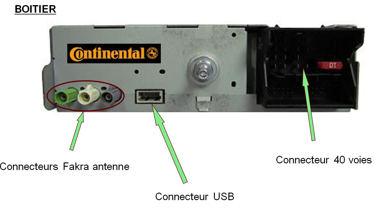

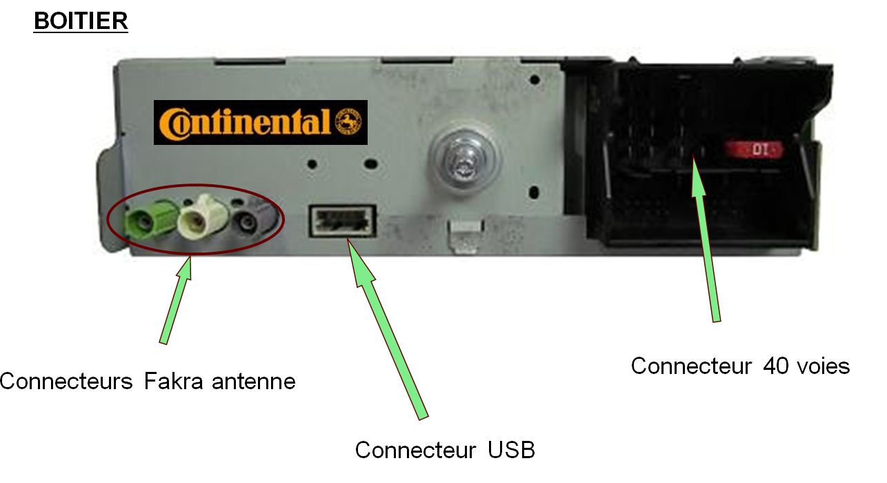

There is a green connector next to the 2 aerial sockets on the back of the RD45 radio.
Can anyone tell me what this connector is for please?
Dave
zoomug
Messages: 9
Inscription: Sam 14 Fév 15 16:57
Re: Peugeot 308 RD4 to RD45
Messagede dolby » Dim 22 Fév 15 11:38
it is a connector for Terrestrial Digital Multimedia Broadcasting
dolby
Messages: 815
Messagede zoomug » Dim 22 Fév 15 15:25
Ahhh ... Ok, so to receive this digital radio, do I need another type of aerial and connector?
Dave
zoomug
Messages: 9
Messagede austinman » Dim 22 Fév 15 15:29
You also need this type of radio to be broadcasted in UK. :super:
Messagede zoomug » Dim 22 Fév 15 15:46
oh.. so it's not DAB? :rouge:
zoomug
Messages: 9
Messagede austinman » Dim 22 Fév 15 15:48
I think it's DAB. ;)

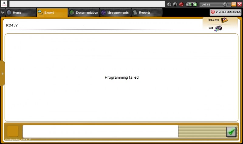

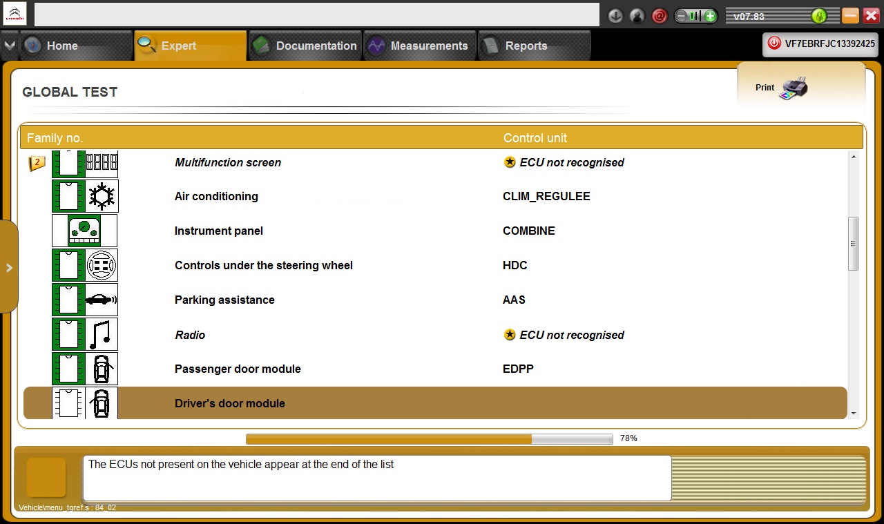

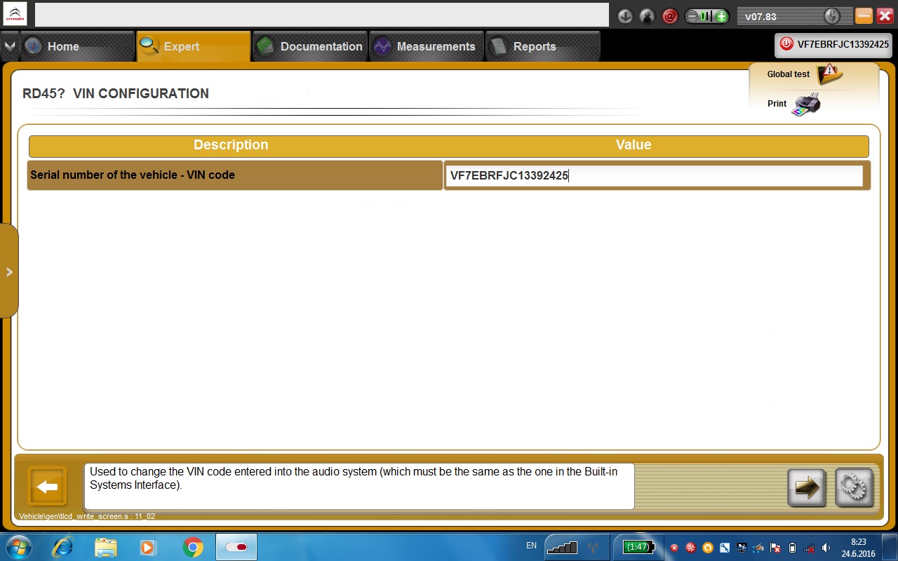

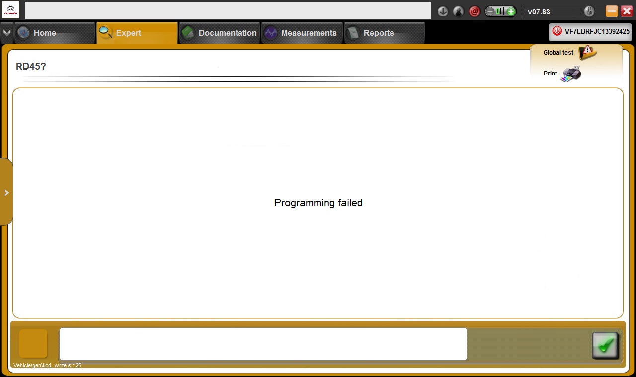

Messagede romsmat » Ven 24 Juin 16 10:26
Hello,
I am Roman from Czech Republic and I have a same problem with vin coding. I know that is more than one year old discussion, but I can not find more relevant.
In my C8 2008 (sorry I have not Peugot now, but I had:-) I changed RD4 to RD45. Everything working fine, but radio still beep beep beep... I know that means my vin code in RD45 is diferent from my real vin code. I have tried many times rewrite vin code in my RD45 but without succes. I am using Diagbox 7.83. It is not able to recognized the radio, but i can configure it. But when I put correct vin code, diagbox answer me "Programing filed". Please see pictures bellow. Have you any advice or recommendation?
Messagede dolby » Lun 27 Juin 16 23:33
your rd45 comes from what Car?
It's new?
trying to put in another car to enter your VIN
like 307/308/c4
dolby
Messages: 815
Messagede romsmat » Mar 28 Juin 16 13:36
It isn't new, I bought it on Aliexpress. It was produced in +-2013. I dont have idea from whitch car it is, but I know the vin in radio: LDCA13R40E2215409
