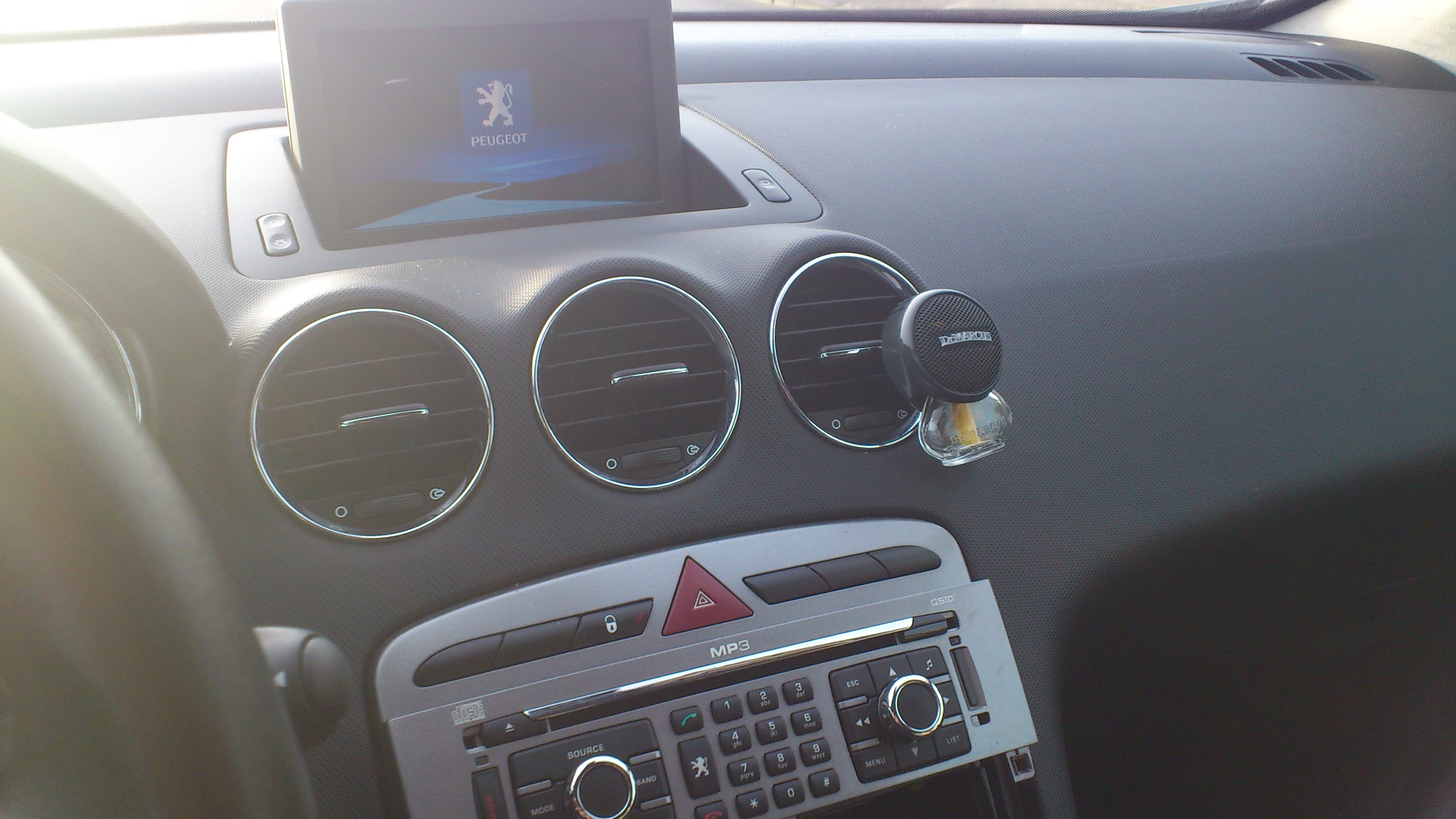

Here that at me only it is loaded
foto radio

I tell so about HDD a disk as when get the car a radio tape recorder highlights (Peugeot, on photo) and is audible that tries will be loaded but it is impossible. I gave HDD a disk to specialist to check up the worker it or not and they have told what not the worker, possibly problem with a boards HDD.
